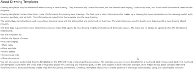

I think you might want to look into drawing templates. Take a look at this article.
I have looked at using drawing templates. Haven't found a way to configure the drawing template to automatically pull the annotation from the model and place it on the drawing using a drawing template.
Can anyone point me to a help document that explains how to do it using templates?

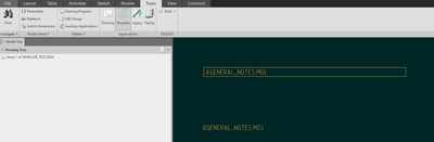

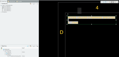

Well, one way I can think of doing this is:
1) make / revise your company templates or formats and include in them a callout for displaying a model parameter:
2) In your model, create a parameter (of type NOTE) and its value will be the ID of the model note that you are going to be displaying in your drawings.
(here I called this parameter GENERAL_NOTES)
3) now when you use the template to make the drawing of the model, the designated note will show up "automatically".
You / your users will have to designate which note will be shown by populating the value of the GENERAL_NOTES parameter in your (legacy) models.
If your start parts have this parameter with its value pointing to the included standard note, then this will be pretty much hands-off automatic for new models...
Hope that makes sense.  Above example shows a template which has a table and a note showing how the result shows up.
I haven't tried it with a format, but I expect similar results.

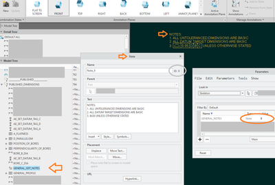

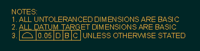

PS. this is how my example note looks like in the part model:
- the GD&T feature control frame doesn't come through very well on the drawing.
So seems there will be limitations, but should work for basic text.

Yes, I'm using annotation features.  The example I show uses a flat-to-screen note element but the method will work with notes with leaders and attached to model geometry.  Here's the composite (redacted) screenshot of the model that is being shown on my example template / drawing:

There is the notable problem with my proposed method in that GD&T symbols rendered properly in the model are not displayed correctly on the drawing.
That is most likely a bug that PTC needs to fix, but I'm out of other ideas to your continual ask of being able to automatically show 1 or 2 model notes on the new drawing.
