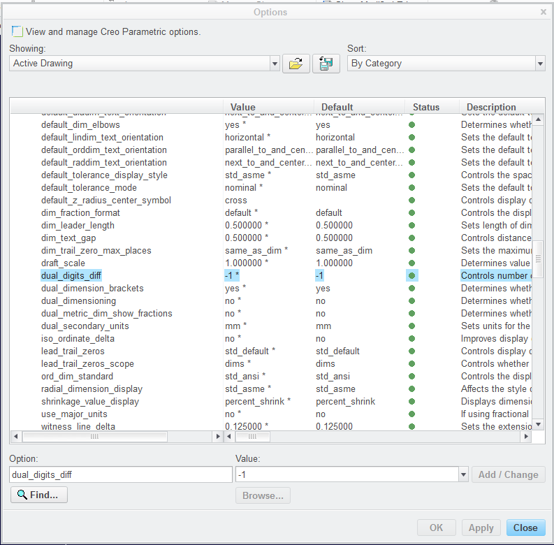

Dual_digits_diff in your detail config.
This will change ALL of them. I don't think there is a way to change just one GTOL's digit difference.

Dual_digits_diff make the secondary unit decimal placed difference
For example, in this case, if I enter the four decimal places in Inches like .0027, in secondary units it will show three decimal places. this is not the thing I want.
what I want is to show 3 decimal places in inches (primary unit) even if I enter a four decimal number. it should round up to three decimal places when I enter four decimals number.
Example: if I enter 0.0027, it should round up and show 0.003 in GD&T. Like that.
then it will automatically show the conversion in secondary units as 0.07

We run into this all the time. The best you can do is increase the number of decimal places displayed.
In my opinion, Creo should really be rounding down the dual dimension value for GTOL's. Rounding up often causes the secondary value to exceed the specified limit.
The real answer is to stop using dual dimensions. Between truncation and rounding no one is happy.

It is duAl dimensions, and you can use +1 to have more places or 0 to have the same number of places.
Also, compare the actual number you are displaying to the conversion and you will see there can be 10-25% mismatch between the conversion and the tolerance leading one facility to make parts that will fail at another facility and will probably fail in use.
