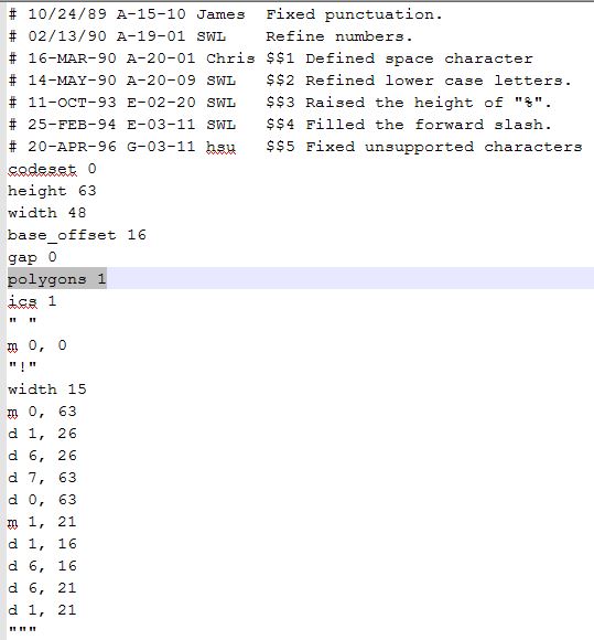

look into filled.src. I guess the header of this file contains setting related to filled display of the font.
Martin Hanák
Hi Martin,
Thanks for your reply. In filled.src they defined polygon 1 at top and similarly if we define polygon 1 in special.src then it creates all fonts as filled.
So is it need to add our custom filled symbol in filled.src instead of special.src ? I want final symbol library as shown above.
I guess that the main problem is a fact that you cannot define font, which contains mix of filled characters and non-filled characters. Unfortunatelly I cannot give you any suggestion how to solve your problem.
