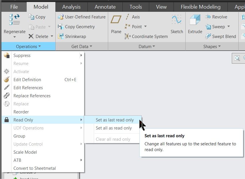

You could try 'set read-only features', I am not sure if this improves regeneration time...
