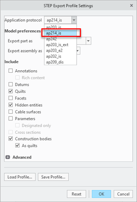

2. You can export the step file with colors from CREO parametric.
Use ap214_is protocol to export with colors:
