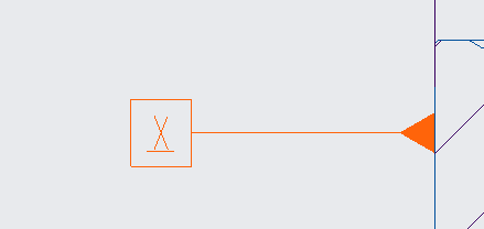

2. Another question is about changing the display type of the datum in the drawing to the following format, could anybody propose a solution?

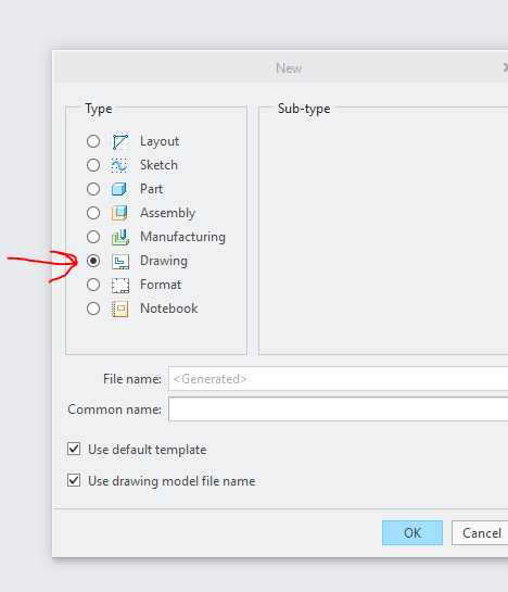

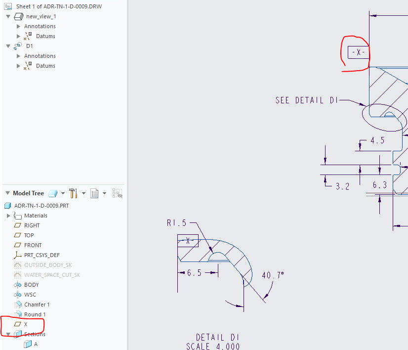

Thanks for introducing a useful video. If I want to generate the drawing of a part using drawing environment (shown in the first figure), should I define the datum in the drawing tree or I could bring it from Model Tree?
When a plane converted to a datum in the model tree then it appears stuck to the surface without an elbow in the drawing (second figure), is it possible to add elbow to the datum (third figure)?

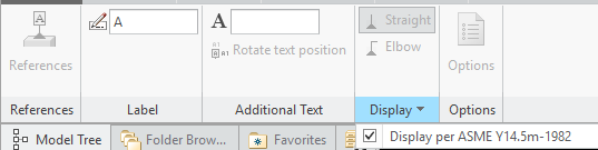

The box is ASME Y14.5m-1982 standard. If you want a plunger instead just uncheck the display check box:

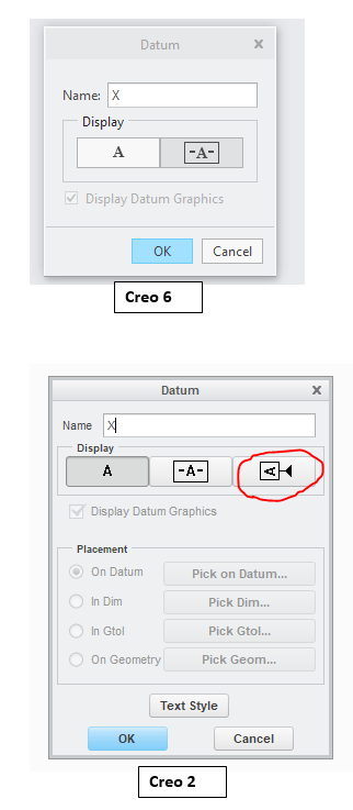

Thanks for your comments. For datum created in the drawing file, the display option could be used to add a plunger, but when the datum comes from the model, I don't know how to change it. It seems that in new versions the datum should be created in the drawing mode to manage it easier. To make it clear what I mean, the following figure added to show the datum properties in Creo 2 and Creo 6. As it showin there is no direct adjustment for the display of datum in Creo 6 parametric.
