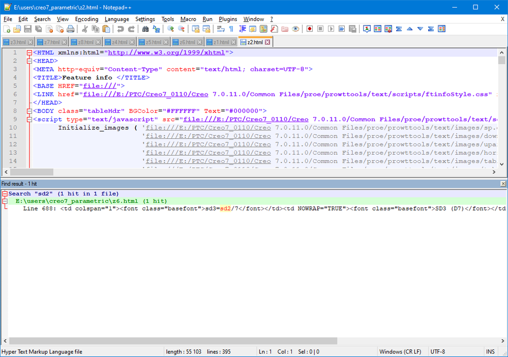

So I generated trail file (trail_feature_info_02.txt attachment) containing the above code for all 8 features.
Then I played this trail file in Creo.
8 html files were created
I opened them in Notepad++ and searched sd2 string in all files.
Now I know that section relation sd3=sd2/7 is included in Feat # 6.

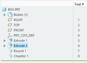

I "developed" following procedure a couple of minutes ago.
My model
When I display Feature information related to Extrude 2 in browser, I can see following information.
Following trail code selects Feat # 6, displays Feature information, saves information into z6.html file and clears selection buffer.
