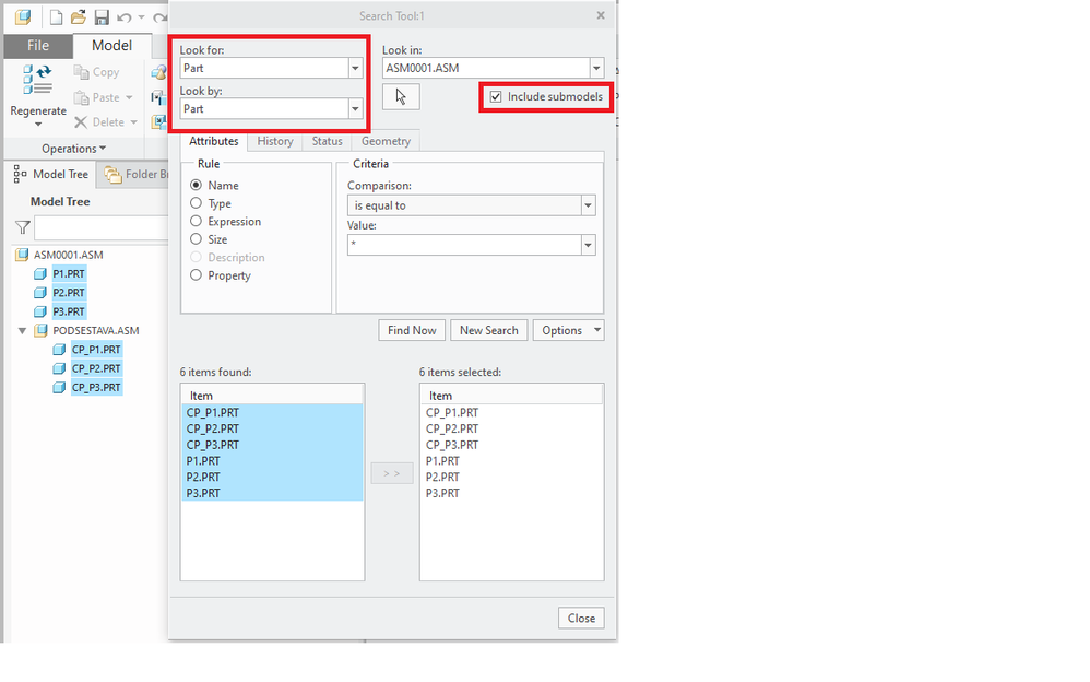

tip: To select parts, you can use Search Tool (binocular icon at the bottom of Creo window).
Martin Hanák
Thanks for the tip!  It'll help make it easier.
