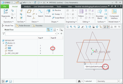

Hi there,
I'm tring to develop a program with using Pro/Toolkit and it needs item IDs (not feature ID) for parts and detum planes.
How can I see them with Creo Parametric?
Pettersson
(To:Yu_707)
See this article: https://www.ptc.com/en/support/article/CS96624
  • Set configuration option show_selected_item_id value to yes
  • Two methods:
  1. Internal ID via Mouse-over tooltip:
    • Select none, one or multiple items, depending on the item type
    • The selected item's ID will be displayed as a tooltip next to the item name, when hovering over the item (in the selection)
    • Format: NAME:TypeID(TYPE NAME) ID=Internal ID
  2. Internal ID via Pick from List:
    • Do not select anything
    • Hover over the item in question, for instance a 3D solid surface
    • long right mouse button click >Pick from List
    • The list will show the surface and optional selections, including each ID

Thank you for your suggestion. Now I can see the item IDs and set model handles with TOOLKIT.

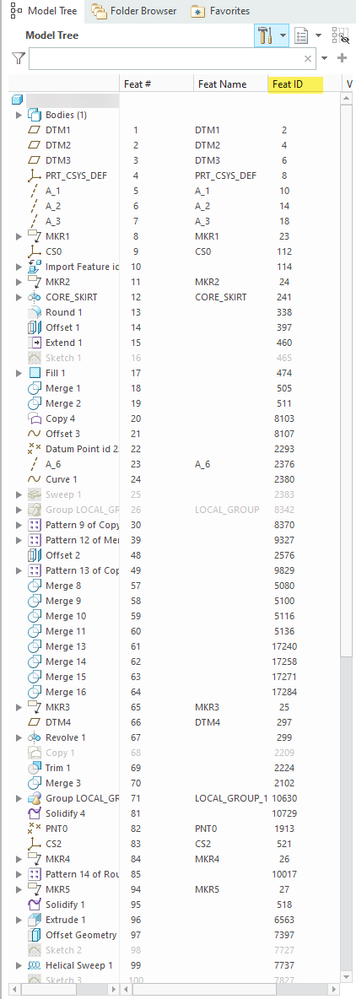

tbraxton shows the way to show feat IDs in a model tree. Do you know if it's possible to show the item IDs in the model tree like that? It would be better way to check the IDs and make easier to code.

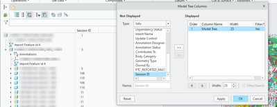

In the model tree, in later versions of creo, session ID was added as an option to display.,
Pettersson
(To:StephenW)
I think Session ID is still a different thing from Item ID. Item ID is only used for Toolkit programming, as far as I understand. So yeah, we have:
  1. Feature #
  2. Feature ID
  3. Session ID
  4. Item ID
It's a bit of a mess. 😀
tbraxton
(To:Yu_707)
If you need to do this more than once for a single feature then I would suggest adding the feature id column to the model tree, you can see the id for all features without any UI clicks/picks. Using the tree should be much more efficient when debugging code.
