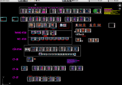

My company is only using Creo for 2D and 3D, So, I need to check as My customer AutocCAD Drawing sending
how merge multi drawing drw (drawining have already) to 1 sheet in Creo Drawing, for autocad file import DWG multi file when import all drawing same 1 position can't move seperate each dwg in other place"

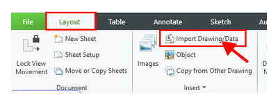

Procedure of "merging" Drawings
1. Open a drawing.
2. Click Layout >
Import Drawing/Data. The Open dialog box opens.
3. Select the source file to merge into the current drawing. When you select a file, the source file is merged into the current (target) file.
4. Select additional source files to be merged, one at a time, to add additional sheets to the current drawing.

I am unable to understand why anyone would want to import AutoCAD Dwg files into Creo. However, you may use this facility available.
Hope this satisfies...
