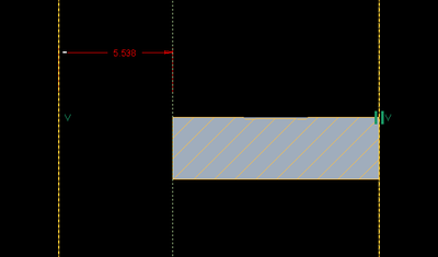

Hmm, I don't get the problem here.  Maybe it's a Creo 10 issue?  In a Creo 4 sketch, if the 2nd centreline was auto-dimensioned to some model edge or datum instead of the 1st sketched centreline, then I just re-dimension the sketch:
red= weak dimension auto-generated by the system when the 2nd centre-line was placed in the sketch.

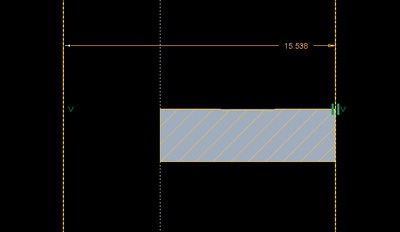

the red weak dimension disappeared when I added the intended dimension (yellow)
(note: the colors are from my user-defined color scheme)
