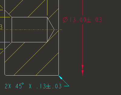

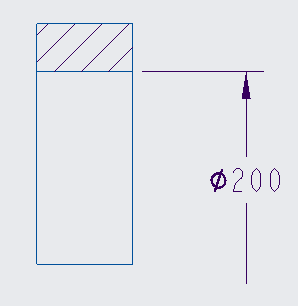

Hi, I'm making a drawing of a simple revolved part. It can be represented as one half section projection. However, I can't draw the dimension line for the diameter how I would like.
In the first picture is my drawing now. The second picture (simplified case) shows the standardized way of drawing dimension lines in half sections in Finland. So I would only want the upper part of the dimension line and no arrow in the bottom end

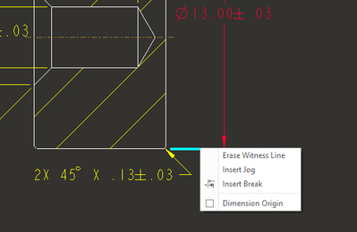

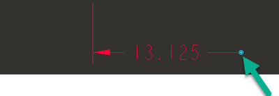

Select the dimension and you can move the end of the extension line anywhere you like.

Select the witness line you wish to remove, RMB Erase Witness line.
You can control the arrows (double/single/none) in the drawing setup using
clip_dim_arrow_style
Kivi_Kn
(To:StephenW)
Oh, you are right! Before I had not erased the witness line complitely but rahter just made it really showrt and that wasn't possible. This is even better than the solution below since now there is no messing with the half views. Thanks a lot!

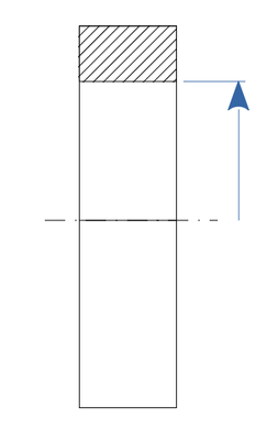

In Creo 9.0 it is possible to create Half view - see following picture.
I hope older Creo releases enable you to create this view, too.
To get requested result you have to create your view as two separate half views -OR- you have to overlay the full view with a half view.

I'm using Creo 6.0. After some trial and error I managed to do that. However, the solution from StephenW does not require messing with the half views. But thanks still!
