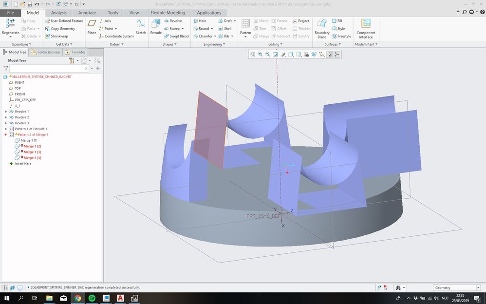

I need to make a pattern of a merge from an extrude with a resolve.
As you can see in the picture only one of the 4 tabs is how it should be. the pattern of the merge has some sort of error.

maybe Geometry Pattern will help.

You may try copying the quilt after merge and then pattern the copy.
