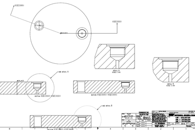

Good morning,
Refer to the above screenshots, where is the switch in CREO to turn off the ghost lines so that I can print and issue the drawing to production?
Thanks.
Best.
JS

I don't think I have seen lines just appear like that. Is there geometry behind the port that would look like that?
Sometimes surface quilts show thru or cosmetic threads but you usually see them on the creo drawing and not just on the PDF.
You may try to turn you background to black using File - Options - system colors and there is a drop down box for "white on black" just to verify that its not somehow white lines on the white background.

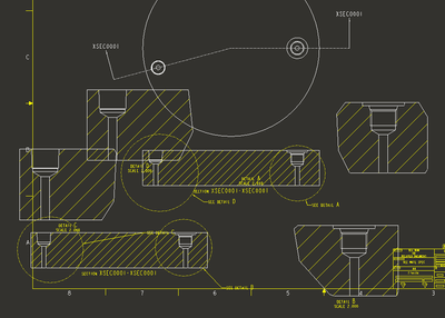

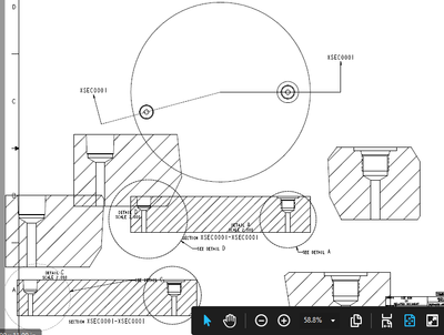

JS_9824412
(To:StephenW)
Hi Stephen,
See below, the ghost lines belong to a thru hole on the other side, however, there show up in the detailed view not in CREO drawing mode (note: I did check both "white on black" and "black on white". In fact, I worked whole day on last Friday with "white on black" setting), but in PDF print out.
Thanks for replying. (This is CREO 6).
StephenW
(To:JS_9824412)
I can't recreate the problem. I tried fully aligned and full unfold x-sections. I got nothing similar except one of the thread lines missing in the the un-fold x-sections.
Its some kind of glitch based on the section but not sure how to fix it.

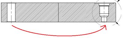

StephenW
(To:JS_9824412)
Infuriating! How did you create your offset x-section? Can you add a screenshot of the it?
How many "lines" (should be 2 lines) are in the offset section? I have seen on occasion when many lines are used to create the section, it will start to get weird.
Do the lines of your offset section go exactly thru the center of your round part?
These views typically just work without any thought, so trouble shooting without the model/drawing is challenging.
JS_9824412
(To:StephenW)
StephenW
(To:JS_9824412)
Looks reasonable. I got nothing.
