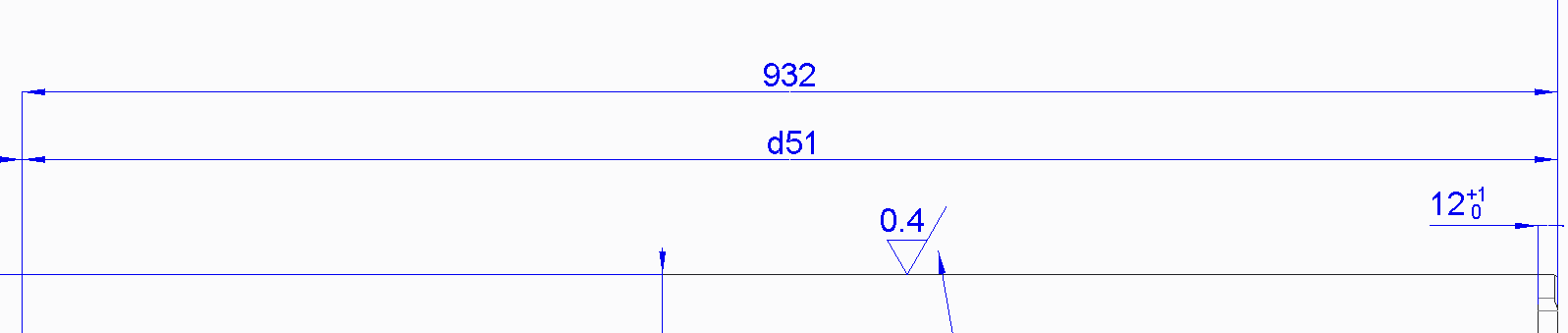

OVERRITED.jpg NEED TO CREATE BASIC @S DIMENSION. HOW TO DO SAME.
ALSO SUGGEST FOR @O BASIC DIMENSION.

For @s its only taking whatever mention in name it wont allow spaces.
I need to mention DIM C so I am mention Name as C & in description I am writing DIM @S
It results DIM BASIC C not BASIC DIM C.
Please try with same . I am forcing @S because it will not give any error while running MODELCHECK regenerate.
For @O it is showing : Owerrited dimension as a warning

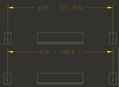

is it possible to show both the @S and the @D?
That is, let's say I have a dimension named d71 which values 750 mm, could make it displayed like "d71 = 750" ?

It is not possible to show both @S and @D you can however add a relation to set the value equal to a parameter or to set another dimension equal to the same and then show the parameter or second dimension.

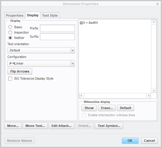

I have put the two parameters in two different dimensions, like this:
Is this what you were meaning?
StephenW
(To:tleati)
This is what I was refering to with respect to a created dimension.
The @S ("shown " dimension) is d38  and the created dimension is ad64
In the properties of the shown dimension, @s = &ad64

ok now I got what you mean, thanks. So I should keep the ad64 dimension in order to display the other d38=225.
I was wondering whether it was possible to have just one dim displaying d38=225.

You can't show both the symbol and the dimension without some other trick. Chris' method of createding a parameter that is equal to the dimension and adding that to the text would work well too.
You don't have to display the created dimension, just don't delete it. You can erase it.
