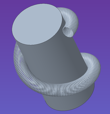

I am drawing a blank on how to model a coiled extension spring.  The simplest example would be an extension spring wrapped around a cylinder.  Any suggestions?  I am currently on CREO 7.
Something like this:
Creo 7 attached.

I can do a regular spring.  I want to model the spring wrapped around a cylinder.  A spring coiled up.
Their website is down for me right now, but I usually go to Lee Springs and download one of their models as a native Creo model. You can then edit the parameters to drive the spring to whatever you want.

I'm moving to 10 in the next couple of weeks if you want to send the model, but it sounds like your spring is just a regular straight spring.  I want the spring wrapped around a cylinder; coiled up.
Creo 7 attached.
That is it.  I should be able to take this and modify it to my needs.

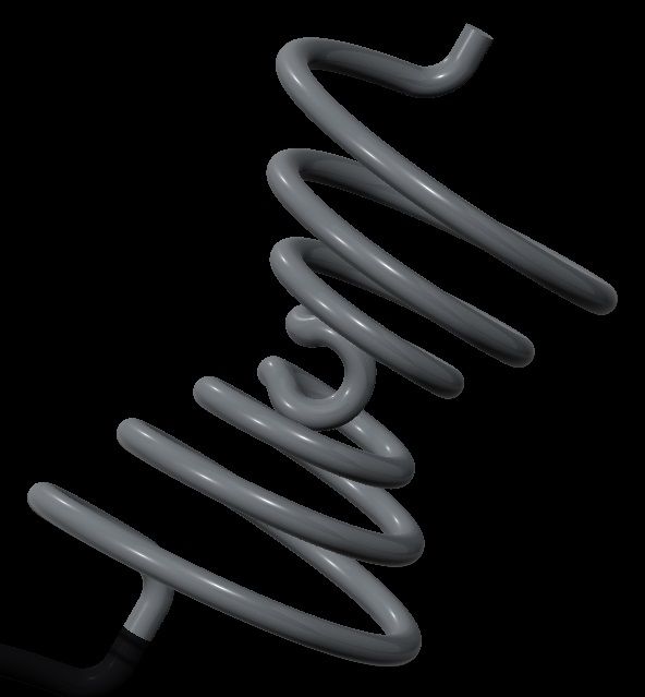

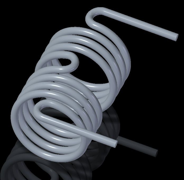

That's certainly not what I would have thought of as a coiled extension spring.  I think if you would have included a photograph or sketch it would have helped people help you.
For a "coiled extension spring" I would have expeced the need to be something more like these:
