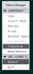

I imported an assembly and now the components are "fixed" but I want to move a sub-group of them to another location.  Doing "edit definition" I can move a single component using the dragger.  But I have several (hundred) to move so doing so one by one isn't appealing.  I guess I can restructure the ones I need to move into a sub-assembly, then move the subassembly with the dragger, and then restructure out into the parent again, but seems tedious.
I found this menu under component operations:
and the transform tool looks like it takes me through all the steps needed to make this move (simple translate along the principal coordinate axis) - yet nothing happens...
Am I missing a step?  Or is there another better way to do this?

see transform_translate.mp4 video.

Thanks!  Not sure why but I was missing the final step of doing the "regenerate" action.
