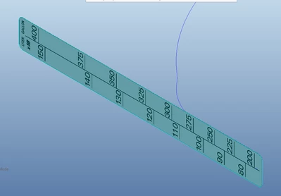

Hello everyone, I’m using Creo 8.0.9 and I need to create a sticker adapted to the surface, but for that I’m using a decal.
When the sticker is flat, applying the decal is easy, but when it’s curved, it becomes very difficult.
Is there a better method?
Or is there any parameter in the planar mode that can be set to automatically adapt to all surfaces?
the surface its a extrude on a spinal bend

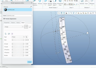

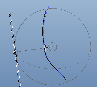

Almost but for me the planar its  very difficult
ps planar isnt that diifficult thank you
Hi
It's unclear how this response was classified as an Accepted Solution because it doesn't address the issue in @ND_10940562.
The quilt in this case has multiple surfaces, and the appearance is applied to each one separately in Creo. Using a decal as a texture will not result in a uniform appearance across the entire quilt. A different approach is required to ensure even coverage across all surfaces.
In my view, my replies are getting mixed up, even though I’m responding to each comment individually.
However, after watching the suggested video and applying the decal using the planar method, that was what actually worked.

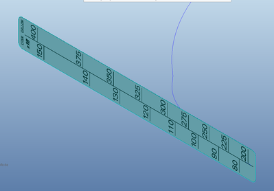

Hi @ND_10940562
The result looks great!
Could you share a video showing how you managed to do it? Alternatively, could you also attach a simplified model that
includes the bent ruler?
