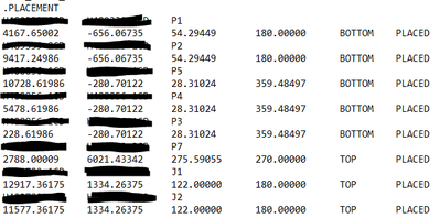

Yes, all the components are being exported (I did specifically have to go in and flip some coordinate systems around to do so and get the export status set to "YES" on all of them). When I open the emn in the notepad, they're there like this (part numbers redacted):

I assume you are using IDF 3.0 if not please clarify which version.
Without actual files it can be tricky to get to a root cause.
The .emn has the component location and orientation info in it when exporting out of Creo, this is good. IME the most likely cause of this type of issue is related to the csys of the components and the PCB and how they are managed. There are default ecad names for boards and parts that Creo needs to manage, have you configured these with your config options and start parts? Do you have a hint map file for components within a library or project space?
One thing to check is to make sure that the Z axis of the component ecad csys for all ecad components is normal to the PCB placement plane (top/bottom). For the PCB itself the ecad origin must have the z axis normal to the thickness of the PCB.

Yes, IDF 3.0 and the z axis are all normal to the board (it wouldn't export them otherwise).
I have not touched anything in the config files and I'm not aware of a hint map file, I'm not really sure what I'm supposed to do there. Our Creo is linked to our Windchill server, so all the parts come from there- so when I send the emn to another mechanical, they can open it in Creo and it gets all the parts from there. So I don't know how Xpedition would get the parts.- they do have a library where they should be able to pull the parts from as well, but I don't know their naming convention ( I could probably find out though) and I also don't know where each part's coordinate system would be.
