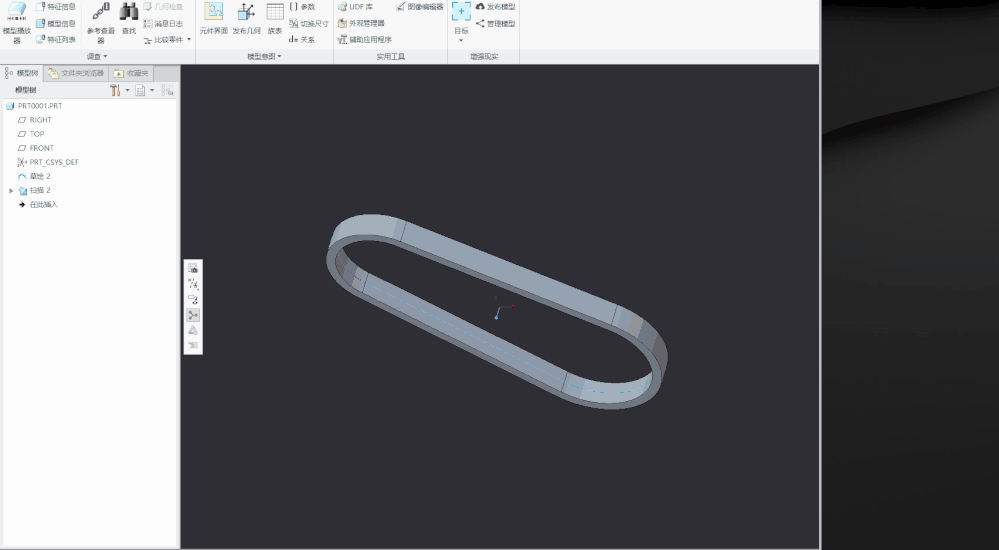

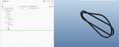

I have a prt(V Belt) where i need to have two models, but show just one at time.
Usually we use one for 3d and one for 2d, but in this case i just wanna have like "one button" where i show one or another.
Creo 8.0.9.0

Hi @ND_10940562
Perhaps you are interested in a Family Table, where you can have one instance for Sweep 1 and another instance for Sweep 2.  This would not be a "one button" solution but it would allow you to show one at a time.
Even creating a mapkey to switch between which is shown/suppressed would require 2 mapkeys, one in each direction.

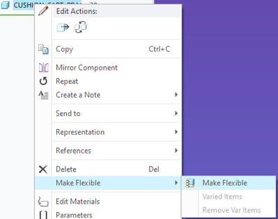

Flexible modeling tools (component flexibility) is a good method to deal with this. It was added to Creo to deal with this scenario of morphing parts. This would use a single model. If you are not familiar with this functionality, you can learn more here.
Edit for the support link to the Component flexibility page. I had initially linked to the wrong support page for this topic.
About Flexible Components

I would like to do it by representation, but I couldn’t.
From what I’ve seen, many people use the Family Table, but I didn’t want to, so I wouldn’t need to create a new code.
Basically, the straight V-belt is the purchased part.
The belt with different diameters is the assembled part and also how it appears in the drawing (DRW).
I’m not sure if I have a license to use Creo Flexible Models. I tried to make the belt flexible, but the option didn’t appear for me.

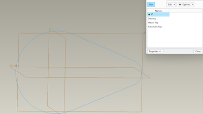

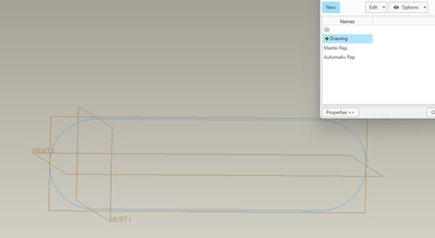

But the problem is that, when using representation, I see two options:
1. Keep both sweeps active in the master rep and create one representation as "purchased" and another as "3D".
However, whenever I open the PRT, it opens in the "master rep" and shows both versions at the same time (like in the screenshot I sent).
2. In the master rep, leave one of the sweeps suppressed and then create another representation.
But in this other representation, I can’t "unsuppress" the sweep.

Master rep is always master rep. it has everything always...
You can make a rep for each.
Within an assy, you can make a rep to only show the 3d rep.
Within a drawing, you can add the the rep so it only shows the drawing rep
Basic license is all that is needed to use flexibility (not flexible modeling, which is also in basic).
Attached is a simple example.

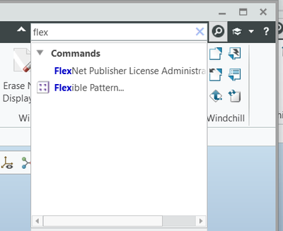

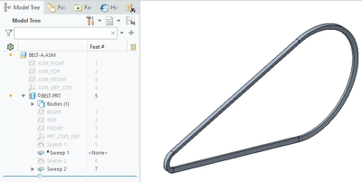

I was able to open the flexible part and saw the option that controls the belt shape.
However, when searching in my Creo, I couldn’t find anything related to "flexible".
See the screenshot below:
(I checked the link about flexibility, but following the step-by-step — right-clicking the component and making it flexible — the option also doesn’t appear for me.)

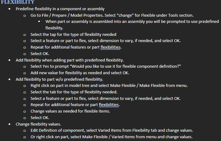

Here is my step-by-step made for 2.0?, but still looks accurate for 7.0.
now i see, thank you so much worked really well here.

your model can contain 2 bodies.
Body 1 ... 1st sweep
Body 2 ... 2nd sweep
You can put bodies in layers and hode/show them according your needs.
Martin Hanák
Thats great option thank you
