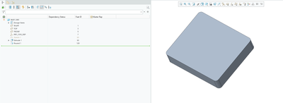

Say I have a a simple extrude with fillets (rounds) on the corners:

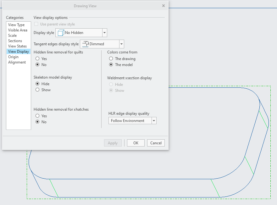

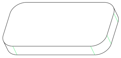

The tangent edges (from the Round feature) appear to be green in the drawing:

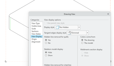

The tangent edges are dimmed. If i set them to be Solid instead of dimmed, then the tangent edges become black:
When I print the drawing (save as PDF) it gomes through with black lines (not green). But I think i have some config.pro setting to ignore pen tables, but i can't remember exactly what exactly it can be. Anyway, it seems to be only a visual thing at the moment, but it is still doesn't look right.
I looked through Creo settings, drawing settings, pen table and I seem to be unable to find anything that changes this colour. Can somebody guide me into the right direction?

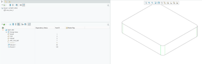

1.] I created new part, set dimmed tangent edges and change their color to green
2.] I created new drawing, set colors from model, set dimmed tangent edges

Hi Martin,
thank you! It is a secondary highlight setting.
How on earth did it make sense to PTC to call tangent edges a "Secondary highlight" I will never know ...
But thanks for your help, I've set it to black and now they are consistent with the rest of the model view in the drawings.
I've marked your answer as a solution.

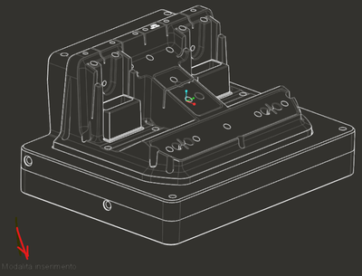

Hi Martin
I too am changing the colors for the tangency display however there is a problem that the secondary selection also changes the writing in the 3d on the annotations of insertion mode, simplified representation etc. isn't there a different way? My problem is not so much the tangency but it's just changing the color of the lettering because the tangency is fine with me as I have it set which is a gray, only on the black background the lettering doesn't show well.
@gcambiaghi wrote:
Hi Martin
unfortunately, I don't know if your problem is solvable according to your ideas.
