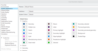

  • Creo Parametric does not assign line width in drawing, specially for models displayed in views.
  • Those lines are only assigned different system colors depending their types (Geometry, Hidden Lines, Quilts, etc). They can be changed in the System Appearance section of the Options menu.
  • Therefore the thickness is not transferred when exporting to DWG / DXF file formats, unless explicitly setting a style and width on each item.
