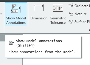

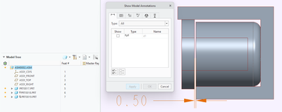

You should be able to select the top level assembly and then "Show Model Annotations":
this should bring up the component placement dimensions into the views, from there you can move them around between views if needed.

Silly me I was trying to do this by showing dimensions, then picking the assembly. Picking the view shows EVERYTHING, but it works.
There aren't any config.pro or drawing options I could find that allow/disallow this kind of thing.
