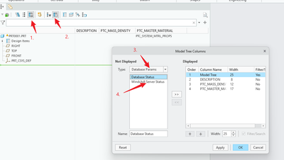

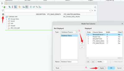

My colleague's computer can display windchill server status. My computer cannot display. How to set it to appear?

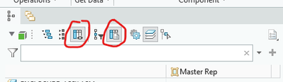

I only have Creo 7 connected to windchill.  For me this button controls showing columns.
Looking at Creo+ (13), the first circled button controls the showing of additional columns and the second one controls which columns to show.

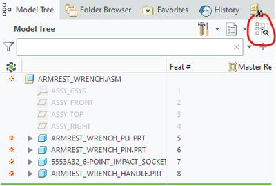

LB_13010411
(To:kdirth)
Great!
