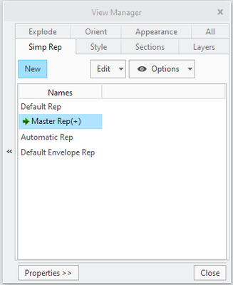

The pictures you took show that you are in insert mode with a simplified rep active.  Are you *positive* that insert mode is not active and you are in the master rep?  (It should show master rep in the text on the screen.)

I canceled insert mode. No effect, that part is still hidden. So just to see I selected the part in the tree and rt clicked>
representation>master and an odd thing happened. The entire assembly disappeared. This is while in master rep.

Nice.  When you selected the part and then clicked representation>master, you created an 'on the fly' simplified rep with just that one component on it.  That fact that you still don't see it confirms that something else is going on.  To get back to the master rep (for everything), open the view manager and double click on Master Rep.  That should remove the on-the-fly rep and remove the plus sign.
I'm wondering if maybe there is a layer issue....  What happens if you go to the assembly layers and hide them all and then unhide them all?
