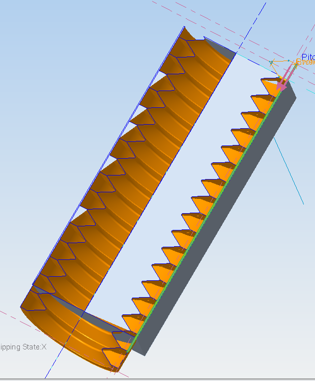

The problem is a helical sweep where the "theoretical" thread cut as a perfect triangle (60/60/60) where the legs are equal to the thread's pitch.
Seems simple enough, right? Reasonable request that you can run that cut feature right off the end of the part, right?
Excusses aside... there is no reason for this feature to fail. And it doesn't fail if you stop short of the end.
The rod is 1" and the pitch is .25. The sketch is tangent both to the surface and the edges are "sharp". Most of us think this simply cannot be done... but obviously it can, just not the way we need it to in 95% of use-cases.
This is the only difference:

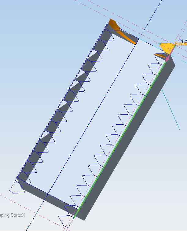

And if you don't use the remove material option:

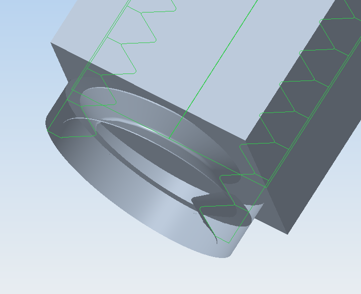

Oh and it gets better!
I tried to make a hexnut by the same token. YOU CAN'T! ... not with helical sweep.
I tried to make a standard hexnut 1/4-28 (UNF) and it wouldn't cut the triangle thread no matter what I tried.
Go ahead, I challenge you: Sharp ID and OD based on 1/28" pitch, 7/16" hex and 7/32 thick.
I ended up having to use the VSS to make the cut. LAME!
If you can accomlish this with the Helical Sweep, please post the file.
Remember; sharp edges using a 60/60/60 triangle shape and NO FUDGING!

Update: Today I got the engineering response tied to other SPRs where this issue is obviously a long time "excuse". The response pretty much said I was lucky it worked at all.
The Pro|WorkAround solution is to make 2 helical sweeps with half the cut. LAME!

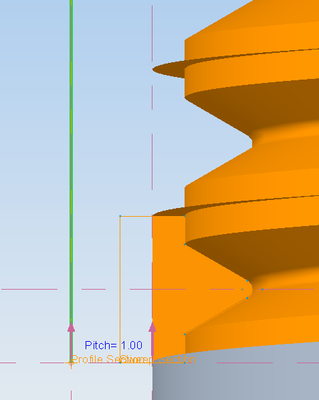

Thank you for you fast reply. The points you made above I had already tried, in vain. However enthused that this is really a simple problem I have come in again today to try different approaches.
  So I started again and drew the approximate geometry that was wanted yesterday. Some interesting observations
  1) Starting with a smaller section than pitch outside the extremities of the original rod, NO thread.
  2) Bring the start within the material NO thread
  3) Being the end within the material Thread appears
  4) geometry adding material works
  Ok so at least I now have a thread set section = pitch, magic it works but see shape
 So now there is a thin remaining material. Must be accuracy? Adjust (e.g. change relative accuracy) - no effect
 Will it work if the thread starts outside the material, now NO  Gives the user the opportunity for continue or cancel, but in both cases NO indication of the error .e.g. no indication of overlapping....
 Move start to 1  pitch distance from the material and the add material option works but the remove fails, again NO error message
 Move to less than 1 pitch distance away and both work (cut still with odd remaining material!)
 Extend the profile beyond the end of the material, fails with both cut and add material (No error message!)
 Set profile to finish at the end of the material, still fails - no error message
 Set profile to finish within the material - still not working
 Change the end position again, this time using modify, and it works!
