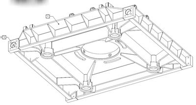

A large part of my current position is large welded assemblies.
This one has about 30 individual parts (over 100 total components), 27000+ pounds of steel.
You have to tell the software how stuff is built. It doesn't take a solid model and determine manufacturing methods. Once you document your model with a drawing a manufacturer can build it. Sometimes manufacturers can take a solid model and build from it, but basically they are going to make a drawing detailing all the steps.
