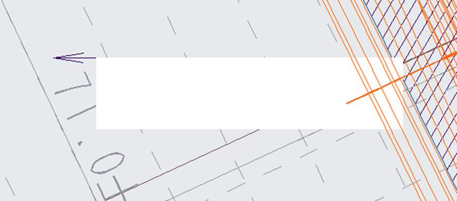

I want to paint the inside of the symbol square white and make the letters ABC black.
NI_8452973
I want to fill the symbol square with white and make the text ABC black.
1. What product and version are you running?
Creo Parametric 9.0.8.0
2. Are you having issues?
I tried hatching and filling, but the text became the same color and became unreadable.
3. Are you using a workaround? If yes, please explain it.
No, there is no workaround.
4. What is the use case for your organization? Explain how your idea works in a disruptive environment or how it applies to a real-world situation.
5. How is this issue currently impacting your organization? (number of users affected, lost productivity hours, etc.)
I'm using the Toolkit to place symbols, but when I place the symbols on a model in a drawing, the text inside the symbols becomes hard to read.
Currently, I manually adjust the symbol position after placing the symbol, but this is time-consuming due to the large number of targets.

AFAIK in Creo it is not possible to determine the order of placement of overlapping objects. I.e. it is not possible to set the black text to be placed above the white square.

Thank you for your comment.
It's a shame that it's not possible.
I hope it will be possible in the future.
