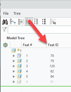

You can search for components by ID but I would recommend adding the ID column to your model tree. It might be a little easier to work with. See below:
In your model tree:
I didnt know you could do this, it help a lot thank you !
You save me a lot of time.
