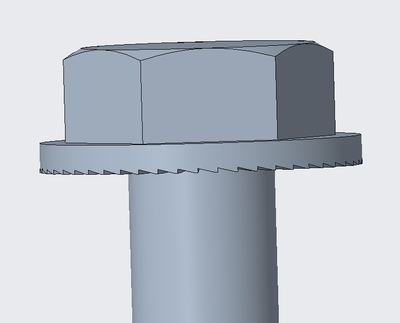

I'm using IFX to create my own custom library.
I've added a few hardware components. Everything is operating OK, but when I use IFX, I do not get the accurate representation of Screw in 2D and 3D previews.
Images are included here.
Please let me know if anyone knows how to fix this.
I did not find anything related to apperances settings in help section.
With custom lib -
With Default Library
IFX only has previews for the predefined types.
If you have a type, which is not available, you can use type 99.
For this type only the maximum outline will be shown.
Together with your own screw icon you will have a good preview.
Hope this will help.

I am looking for some custom representation here like below image ,
I checked to use custom screw using Screw type 50 , also created prt file and template for Screwtype 50 ( attached here, just remove .txt extension). But I guess Creo does not allow custom views like above image and only allow standard Hex head/round head views.
Oliver Gräbner
B&W Software GmbH
Thank you for reply.
Actually i checked in Creo help and thaught that we can set custom appearance for Screw heads for this screws, but it seems for now IFX do not allow custom Appearance for custom screws, Only Preset appearances -
1) Cylinder Head
2) Hexagonal
3) Countersunk
4) Lifting eye
5) Button head
As an idea, please check possibility to add screws like Flange screw in this appearances.
Thanks again for your feedback.
@Vinayak_Patil as we already have a flange nut we also should add a flange screw.
I will open a ticket for this.
Hope to get this done in near future.
