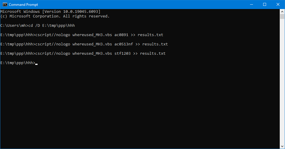

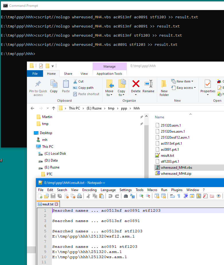

to prevent result file overriding you have two choices.
1.) using different result file names, eg.
cscript//nologo whereused_MH3.vbs PARTNAME_01 > PARTNAME_01.txt
cscript//nologo whereused_MH3.vbs PARTNAME_02 > PARTNAME_02.txt
2.] using >>
cscript//nologo whereused_MH3.vbs PARTNAME_01 >> result.txt
cscript//nologo whereused_MH3.vbs PARTNAME_02 >> result.txt
Note: I modified vbs file to insert the name of the searched part before the results. See attached whereused_MH3.vbs

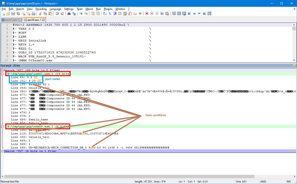

whereused.bat batch file ignores current directory, therefore you have to place it 1 level up. See following picture.
Note 1: You have to enter upper case model names.
Note 2: I added .1 extension to names of assemblies. I thin numerical extension is mandatory.
Note 3: You test part names produce false positives because they are too short. See following picture.

As you said, there are problems with false positives.
I did a test, and for some reason, parts that have been replaced remain recorded in the files.

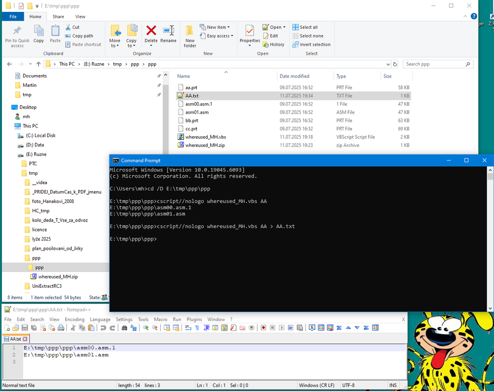

I created VBS script. You can test it.
  • download zip file and unpack it into top directory
  • open Command prompt window
    • change current directory ... example follows
      • cd /D E:\tmp\ppp\ppp
    • run script to display results in Command prompt window ... example follows
      • cscript//nologo whereused_MH.vbs PARTNAME
    • run script to write results into file ... example follows
      • cscript//nologo whereused_MH.vbs PARTNAME > PARTNAME.txt
Note: The script produces false positives, too. You can check them in Notepad.

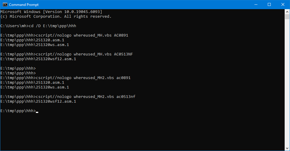

I tried it. In the ppp example, it works, but when I transferred it to a more real-world example (hhh folder), unfortunately, it doesn't give me any results.
Maybe I'm doing something wrong.
The goal is to search for ac0891 or ac0151nf.
The correct search would be this:
ac0891 is contained in 251320 and 251320ws
ac0513nf is contained in 251320wsf12
But in 251320wsf12, traces of ac0891 remain (the part replaced with ac0513nf), and that's what we're trying to avoid by limiting the file scan to #END_OF_P_OBJECT.
I'm attaching the same example I used with bat (ff), which works but gives a false positive because it still finds the name of the replaced file in the asm file.
It's a game, so don't waste too much time.

the explanation is very easy ... cscript//nologo whereused_MH.vbs PARTNAME notation means that the name of the part must be entered using uppercase letters ... see following picture.
I uploaded modified script whereused_MH2.vbs packed in whereused_MH2.zip.
whereused_MH2.vbs converts the name of the part to uppercase letters and you don't have to think about it anymore.
Martin Hanák
2.] using >>
Martin Hanák

My curiosity pushes me further.
Theoretically, would it be possible to do a cross-reference search?
I mean, search only for assemblies that contain two defined parts or three defined parts? Or is that too complicated?
mamobono
searching for assemblies that contain two defined parts or three defined parts is not complicated. I will send you the script tomorrow.
Martin Hanák

yes ... anyone using my scripts uses them at their own risk.
New version of script attached.
Note: The number of arguments is not limited.
Martin Hanák

KenFarley
(To:mamobono)
The DOS batch commands being used are not parsing through the file line by line in any fashion that is controlled and can be stopped when some sort of condition is met. There is no looping structure in the file analysis - it provides a simple true/false result as to whether the target has been found within the file.
One can expect many many false positives if their file naming technique is using very short names or re-using the same names in different projects.
