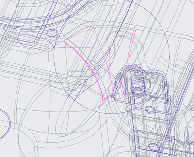

When I import a STEP File that was created with Siemens NX 11, there are a lot of surfaces that fail.
By optimizing the import settings, the load time was improved, but the surfaces still aren't ideal.
Can anyone share a STEP Import Profile configuration?
Thanks for your help!

The Problem is, that we really don't know anything about how the STEP File was created, beyond the header of the STEP file and that it is data from Mercedes Benz. I made an error thinking it was a CATIA file it is actually NX.
There are intersecting surfaces in the STEP models which cause the surfaces to fail.
We have a potential customer, who is thinking about switching to Creo from Catia, he says the STEP files open without problems in Catia and won't switch if Creo can't handle it.

I agree with you both, nearly all complex assembly have some kind of problem, when they are imported.
There are just so many settings in the STEP Import Profile, that I thought maybe someone has found a optimal way to configure it.
The Import Data Doctor in Creo can Help, but our potential customer does not want to spend time on repairing the models.
