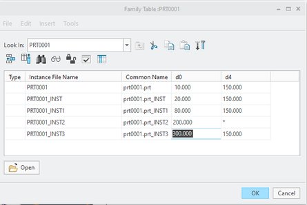

even if this topic seems to be closed: Today we had the same happening in creo 7.0.5. and 8.0.5 as well.
Indeed, the problem was data dependent. It was a familiy table with reference dimensions only (for drawing purposes). Of course, they do not affect the model. So, it was not possible to change them afterwards at all. Neither in the family table UI or Excel.
Freshly created data with driving dimensions works fine.
Of course, it would be great, if the UI would give any signs or messages in such a case.
In my example, d0 is a driving dimension, d4 is a reference dimension (that can´t be modified by user)

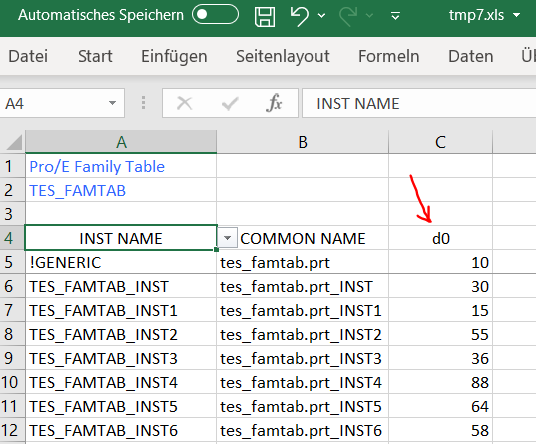

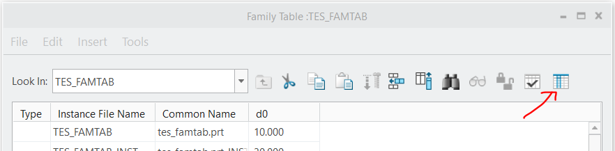

It is possible to create Family tables by using excel.
In my case dimension d0 changes:
In that way, You create a whole new set of data.
