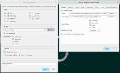

Perhaps there is a setting in Creo's import function for SOLIDWORKS, which controls whether or not Datum features are imported.  Don't know...

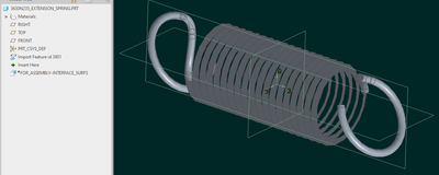

I typically import McMaster-Carr models as "STEP" and use a template, so that the model will come in with planes and layers as per my company standards.
I assume the 3 planes are the original "default planes" from the Solidworks model:
Are doing an Import into your company standard start template file or opening the SW file directly in Creo?
My users have been instructed to always create a new file, then do the import into that file when they import things from McMaster-Carr.

As others have said, use a startpart (template), then import the STEP data from McMaster.  I usually create another Coordinate System in my starting file before the import, then insert the data with reference to the new CSYS.  That allows me to change the orientation of the component, or to move it with respect to the default datums if needed.
