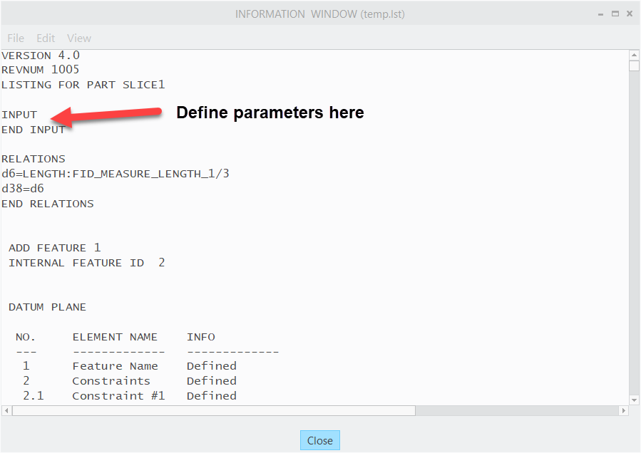

If you are looking to automate the setting the values of multiple parameters in a model then Pro/Program may offer the solution. You can define the parameters in the input section. With this defined, upon regeneration of the model you will be prompted for the source used to assign values to the parameters. One of the options will be from file which will use a previously created text file to define the values.

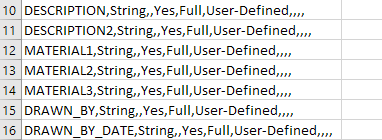

Here is what I get in a txt file:
I believe you are missing the definition of the parameter columns.
Here is what I get in a csv file:
Each column separated by a comma.

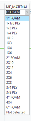

Thanks @kdirth !  Does the information you provided apply to a restricted values list parameter?  I'm trying to create a drop-down list of values like in the image below:

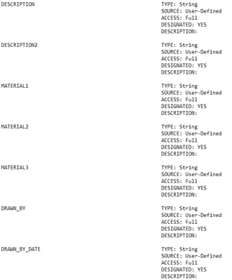

Here is one that I have that is restricted:
The restriction comes from windchill.  The value input in the model would need to exactly match one of the acceptable values in windchill.  I have not seen a dropdown list in the model parameters.  In our system, adding a value to a column in the windchill attributes adds the parameter to the model.
