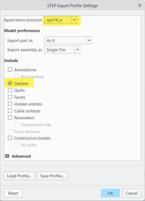

Does anybody know if it is possible to also export sketches or cosmetics into a STEP file?
I've tried several settings but it doesn't work. I've tried also ap214 and ap242 with "Datum", "Quilts", "Facets" and "Hidden entities" all checked but the export doesn't contain any of my Sketches, projected sketches, curves, or other 2D entities.
This would be nice because we can then use it for laser engraving on our laser cutting machine. Now we are using a small cutout and then in the laser cutting software someone is converting this cutting into a single line again.
pausob
(To:RobertH)
I disagree with your statement that there is no real solution.  Please review the answers in this thread.
Seems to get what you need (export to STEP including sketched curves, but not including datum items such as axes, planes, etc):
1) Ensure configuration option intf2d_out_blanked_layers is set to NO (default)
2) Put the datum items that you do not want exported on a hidden layer.
3) Export with the "Datums" box checked:

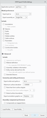

Yes. These are my export settings.
The system you are importing may likely need settings adjusted also.

To include datum curves, you need to configure the export profile to include datum entities (includes datum curves, points, axes, planes). In Creo, sketches are not datum curves so those would not be exported. It seems that you have tried this but are still not getting the desired entities. Confirm one or more of the entities in question is a curve in the native Creo file. If curves are not getting exported then something else is blocking it, perhaps layer settings.
You may need to use sketches to create datum curves prior to export.

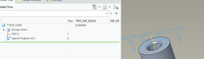

I found out that it was not the export or settings but I was opening the STEP in Creo View and although all filters where off it did not show any sketches or datums entities but they where there,
Now find a way to improve the import in our laser cutting software in such a way the sketches are interpreted as engraving...

Discovered another thing. When you use the "Datums" checkmark in the STEP export settings then an axis is also exported as a line.
Is it possible not to export the axis but still export the sketches?
For me it is also strange that you have to check the "Datums" in order to export sketches, as for me a sketch is not a datum....

Note that if you have the configuration option intf2d_out_blanked_layers  set to NO, then items on hidden layers are not exported.
So then put your datums axes on a layer and hide this layer before export.

There is no real solution which is indirectly caused by the fact that sketches and cosmetic sketches are put under the Datum option which is a bit strange because in my opinion it is not related to datums. Turning the datum export on will also export the datum planes which become a sketch then, this is unwanted.
pausob
(To:RobertH)
RobertH
(To:pausob)
The problem is that all AXIS are also exported when checking the Datums option in the STEP export Profile Settings.
Setting the  intf2d_out_blanked_layers to NO gives an possible workaround but then I need explicitly hide ALLE axis in the model before exporting it. For one time only it's ok but I also want to use the STEP export settings in our worker and then it's 100% sure not everybody hides all axis before checking it in. Besides the manual action I found it not very logical that the Datums option in the STEP export Profile Settings als turns on and off the sketches (as for me sketches and datums are two complete different things).
Left the original, right the STEP
