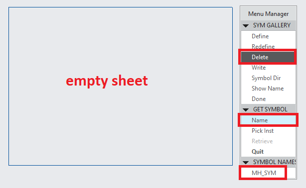

@BenLoosli wrote:
The symbol is not on the drawing.
Selecting it from the symbol library, shows it all capitals in the preview but upper/lower case when placed on the drawing.
I am going to include the latest versions of the 2 symbols that give my users problems as default on a new set of drawing templates I am building to incorporate some other changes. They can then delete the one they do not need.
I am sure that you know that symbol is copied into a drawing during its first placement. Even if you delete it from a sheet, it is still included in a drawing.
Martin Hanák
BenLoosli
23-Emerald II
(To:MartinHanak)
We see that with some symbols, and Creo asks if it should update the old symbol. Not sure what criteria Creo uses to determine if a symbol is old. I have resaved all of the symbols that have been giving us problems last week. I would expect that the new symbol would ask if it want to update, but it doesn't. Some of the other symbols do ask if they should update.
