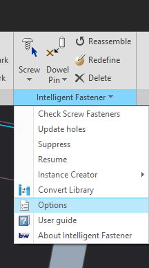

Hi @ptc-174577,
try to change one option. Therefore goto Tools -> Intelligent Fastener -> Options
and change ENTER_DISTANCE_VALUES to YES
Hope that helps
Greetings Sam
Samuel Brantner
B&W Software GmbH
You edit the axis that it creates based on your mouse click.
