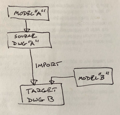

If i change the first page in my first drawing i want to know if the functionalitie exist to update the second page directly
tbraxton
(To:AC_10460838)
I am not sure I understand your stated goal.
The imported "drawing" will remain associative with its parents (models etc.). There is no new "link" created between the source and target drawings when using this import function. The target drawing will have the required models added to it that are needed to regenerate the imported drawing elements.
This is an oversimplified reference map of how this works when importing a drawing. The target drawing ends up being dependent on models A & B. If you want to not have this dependency, then you need to import a different data structure other than a Creo drawing.

Yes i understand your explanation but my question is: If i change the drawing page in DWG A is it possible to report the update in the page in DWG B?
If you add note on DWG A i want to know if its possible to update DWG B without repeate the importation in the drawing B.
tbraxton
(To:AC_10460838)
If I understand correctly then no, this is not supported with the import function in drawing mode. When you import a Creo drawing it creates a snapshot of the drawing at the time of import and is not associative with the source drawing after import.
The solution to your scenario is to import the source drawing after it is modified to reflect the latest version of the source drawing.

Have you looked at the Overlay function?
Hello
Great!!! I didn't know this function but it corresponds to my need.
Now i have 2 solutions: Overlay or use consultation functionalities in Windchill.
Thank you very much
