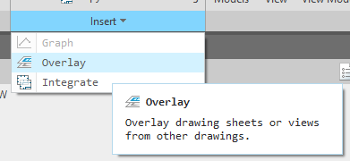

pausob
(To:CD_10645700)
I checked and it is still there in Creo 10.0 - in drawing mode, layout tab, "Insert" group:

pausob
(To:AC_10460838)
Have you looked at the Overlay function?
Hello
Great!!! I didn't know this function but it corresponds to my need.
Now i have 2 solutions: Overlay or use consultation functionalities in Windchill.
Thank you very much
