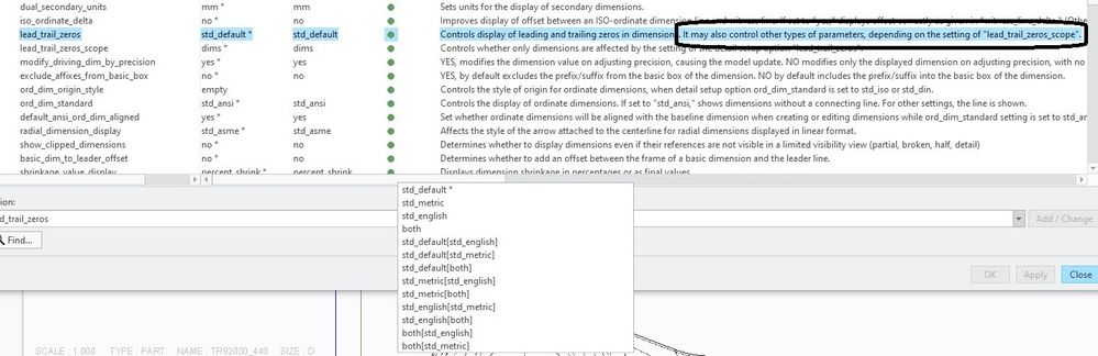

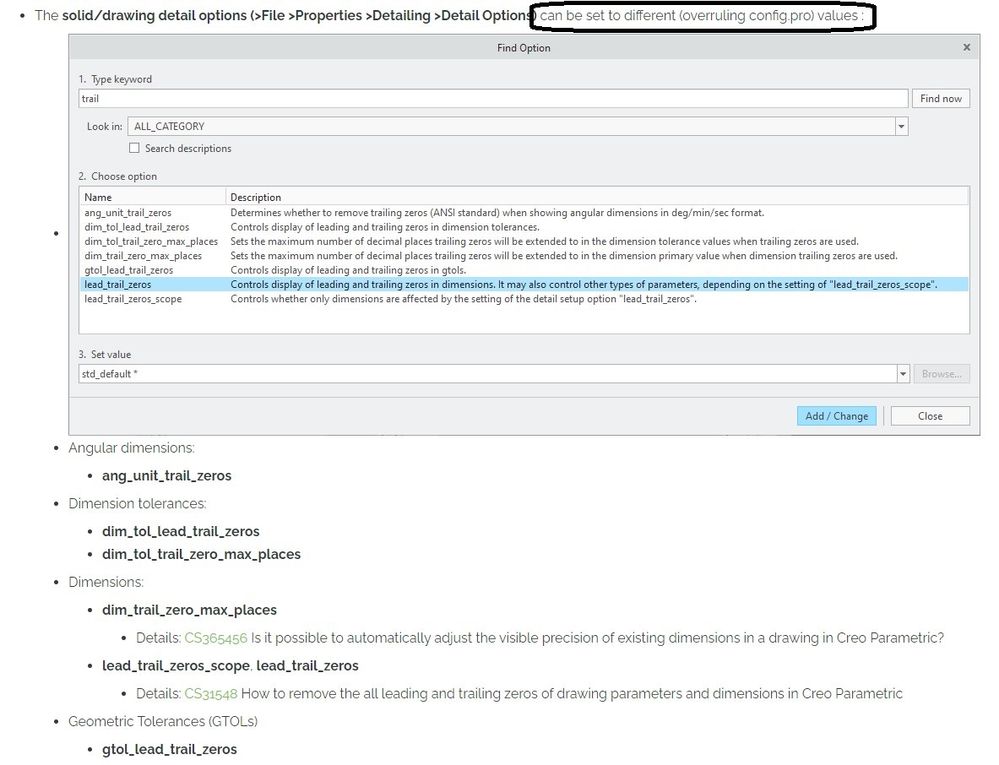

Tbraxton:  Scrolling through the different ways to implementing varying decimal places towards the bottom of the knowledge hub document appears to refer to making a permanent change to these settings.   It also "seems" to suggest that these changes would be set up from the drawing options "lead_trail_zeroes" setting.  See attached area of this documentation.
When I click to change this however (lead_trail_zeroes) from the defaults the drop down choices don't appear to refer to making the system/drawing settings independent from each other.
I am crossing my fingers that this change can be made but from the given choices I'm not seeing where this might be incorporated.
pimm
(To:pimm)
I do believe that I read the last section of the Knowledge Base documentation incorrectly, but it still appears that it is not possible to have system default decimal places separate from drawing "default" decimal places.  I have seen numerous inquiries about this but no instances of where this was accomplished.  Eventually the person looking for the answer gave up or the thread was marked locked.
Where I looked at the last segment of the documentation incorrectly was where I thought the lead_trail_zeros setting applied to the settings below that diagram.  The other settings were just separate independent settings which really only applied to how Creo handles zeros.  This wouldn't apply to what I am looking to do.

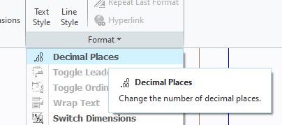

I think that the intent of leading/trailing zeroes is to control the display of significant figures in a drawing. However, some drafting standards (ASME, ANSI, ISO) have rules about this and they are not common among the standards so if you reference a standard make sure you are not violating it with a default setting.
If you need a quick fix to address this while you research config settings, you should be able to bulk select dimensions on a drawing and set the # of decimal places displayed with one UI interaction with dimension properties.

pimm
(To:tbraxton)
Tbraxton:  Yes, the best option in as much as what I have seen for obtaining the needed drawing decimal places has been to region select all of the placed dimensions and make the change.  Applying the same change from drawing after drawing does become cumbersome for what seems to be a simple to implement drawing option.

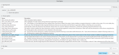

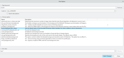

pausob
(To:pimm)
I have couple of more cents to add to this thread.
Note these two config.pro options will affect how newly made or shown dimensions behave:
round_displayed_dim_values
default_dim_num_digits_changes
pimm
(To:pausob)
This does sound interesting but it's a little unclear whether this implementation would help or add some kind of issues.  It might be a good idea to try this out and see whether it does accomplish that which is needed.

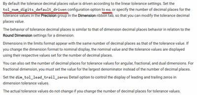

Srinivasan-Iyer
(To:pimm)
I am on Creo 9.x.x.x
While rummaging through the help files I came across this page. Hope this helps. I must admit that I have not tried it since the number of decimal places are set to 3 in my case.
https://support.ptc.com/help/creo/creo_pma/r9.0/usascii/index.html#page/detail/About_Setting_Decimal_Places_for_Dim_Tol_Values.html#
