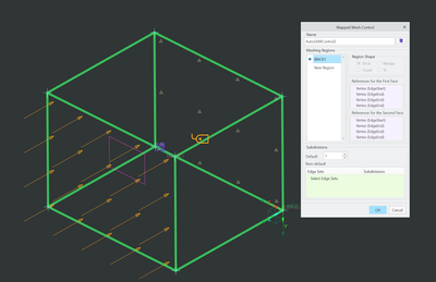

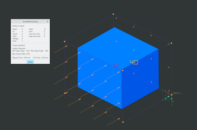

There are some tools to make the mesh match your loading area but not the other way around.
If you wanting to load some smaller portion of a face of your model, you can create regions to put the load just on the desired area.
Also, you can create hard points and hard surfaces internal to the model to force the meshing and to apply loads internally.
Mapped meshing is also another way to control the mesh, for example you could make a single element using mapped meshing to research at the single element level.

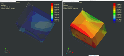

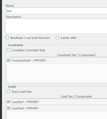

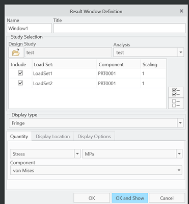

2. Example for two load cases checked independently (use load sets)
Results will be available for each loadset and can be combined with weighting/scaling.
You can also run multiple of these analysis with a design study.
