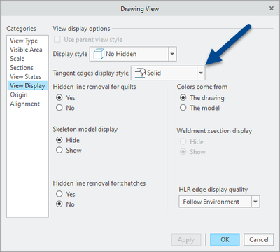

Have you tried setting the tangent edge display to solid? We would normally set this for just the ISO view manually if the tangent edges are valuable.

Yes I've tried this, no luck.
Its only only on round leader pins, and only in the ISO view. They show up in other views. Obviously tried to recreate the ISO with no luck too.
