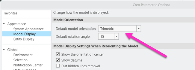

We are in the 3D modelling and MBD world. I don't understand why these views are required. In fact, any view that is not Isomeric is good. The Isometric and Dimetric views are problematic because edges may overlap, therefore, any trimetric view is OK.
I have illustrated the problems with using these views through illustrations.

Then PTC should have made the Default Orientation Trimetric if it's so much better (it's not).  For me, I wanted views that matched the Default Orientation but from all the other angles, and now I have it...finally.  I guess Isometric and Dimetric views could be a problem if you only made perfectly square transparent cubes with no other geometry, but thank God that's not MY job for a living...🤣🤣🤣

Right, but that still didn't give me the information I was looking for.  As mentioned, I WANTED Isometric, and the default is still Isometric, not Trimetric.
