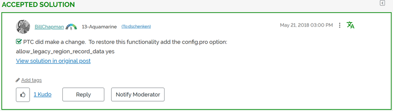

I added the config option as mentioned in this post-
https://community.ptc.com/t5/3D-Part-Assembly-Design/Table-Filtering/td-p/549703
and it seems to be working for me, so far.
