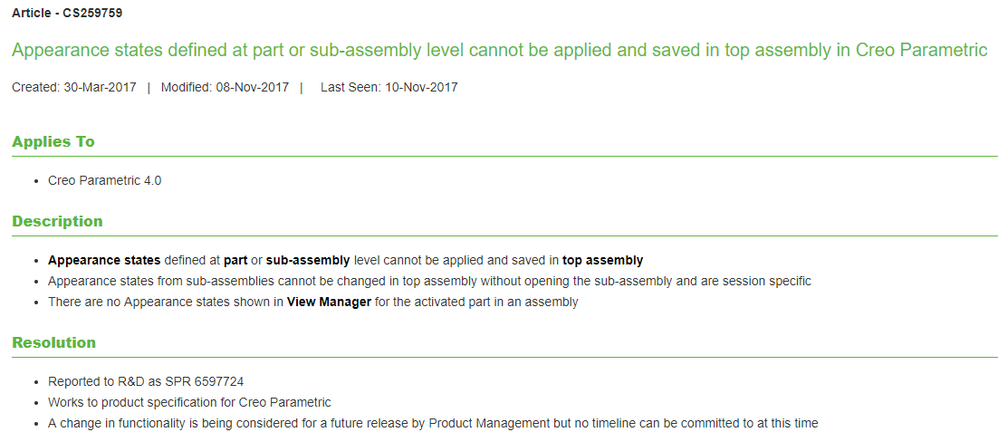

This is not possible in Creo 4.0.
SPR was opened: https://support.ptc.com/appserver/cs/view/spr.jsp?n=6597724
And also article below:

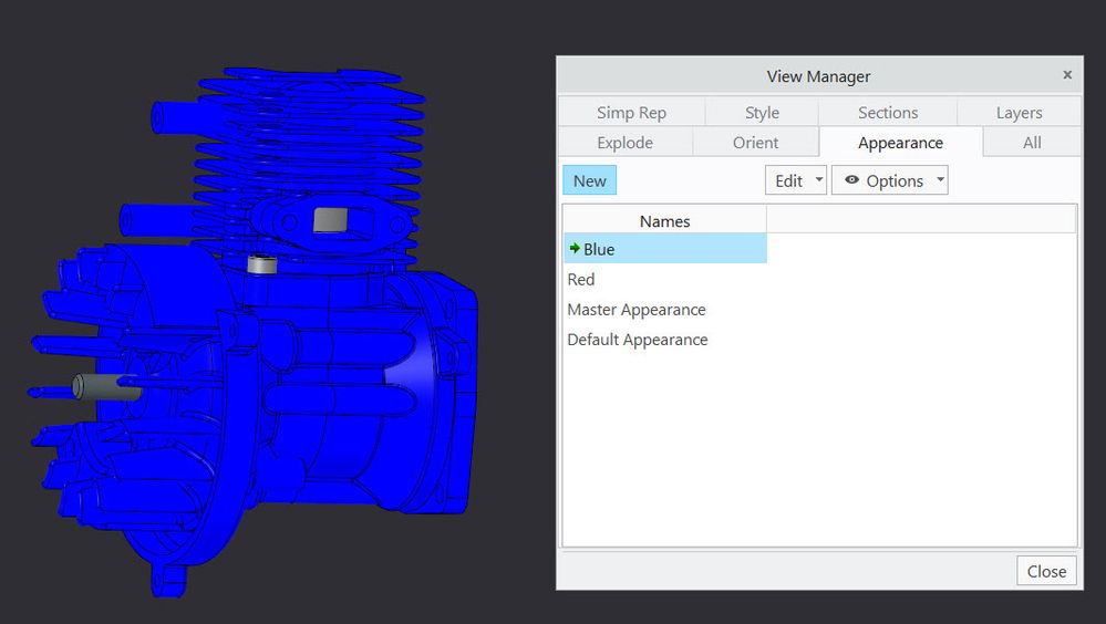

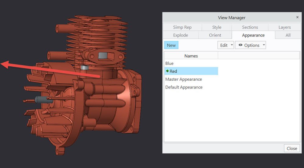

mcestnik
(To:dschenken)
In Creo 4.0 there is an Apperance menu in view Manager which as I understand was implemented for this purpose.
Example:

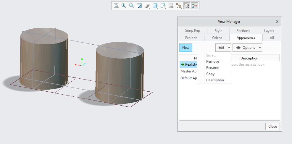

That looks promising. We are switching from Wildire 4.0 to Creo 4, so a big (huge) jump for us.
I have played a bit around with Creo 4. I have managed to create different appearances at part-level, so far so good. But when I place that part in an assembly, I can not "activate" that appearance. The assembly just shows the appearance which is active at part-level.
The options in the View Manager are also very limited. There's no "Redefine" option, so there are also no options to create any "Rule Actions" of any kind.
Domen
(To:HamsterNL)

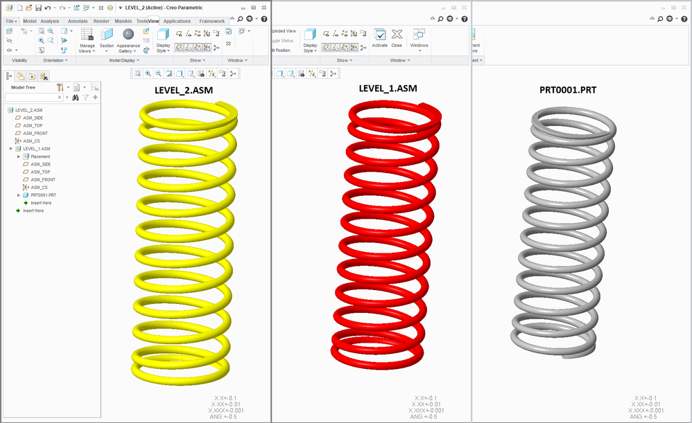

TomU
(To:HamsterNL)
Each successive level up can have their own colors defined for each of the components, but I don't think it's possible to have multiple colors for the same component at the same level.
Part --> Red
   Assembly --> Brown
      Assembly --> Silver
Have you considered placing your top level assembly into another "wrapper" assembly that is just used for coloring things?

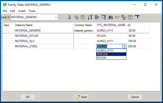

I have lots of family tables for parts, particularly "catalog" items like springs, screws, etc. Part names are as descriptive as possible, i.e. "BHCS-0250-20x1000-BLKOX". The problem is that in the version of Creo I'm using, 2.0, color is not something that can be set in the family table. At least that is to the best of my knowledge. If there is some way to do so, I'd like to know what it is.
@BenLoosli wrote:
I have set up many family tables by material since that is a property that cannot be changed by the FT.
@BenLoosli
You can drive the material with a FT with the "PTC_MATERIAL_NAME" (at least you can in WildFire 4)
When working with sheetmetal, you'll have to add another trick to get the correct bend table.
