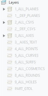

I am learning more about how to use layers in Creo Parametric. One issue I have is the Layer Tree becoming unwieldy. Currently, I have an assembly model with a really long layer tree with a large amount of layers that have no contents. I'd like to delete these layers to shorten the tree and make it easier to read/use. I haven't found a way to automate this process. I was hoping that there would be a filter to show all the empty layers or a "find" function to select only empty layers for deleting.
Does anyone else have this issue? What are some workarounds or methods that might ease the approach to cleaning up the layer tree?

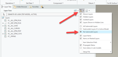

Assemblies show all the layers of all the parts. You can change the display to show only the assembly layers.

Sorry, I did not get back to this because the community ran out of answers.  Yes, one option is to only see the assembly level layers, but that does not help if you must also interact with part level layers.  It also does not solve the issue  -  wanting to delete the empty layers.
