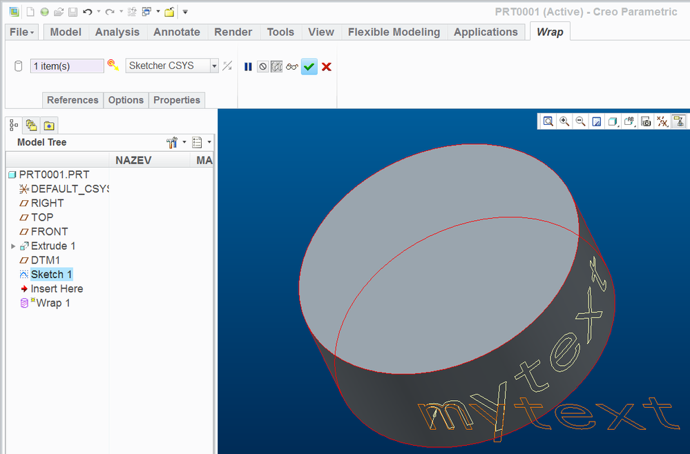

Letters on round surface
ArtinB

How can I create letter groove cuts wrapped on round surface, using CREO 4?

MartinHanak
(To:ArtinB)
use Wrap feature.
Martin Hanák
ArtinB
(To:MartinHanak)
Thank you for reply, but how can I do this text about .030 deep cut?

ArtinB
(To:MartinHanak)
Thank you very much Martin, that what I was looking for, keep up the good work.
