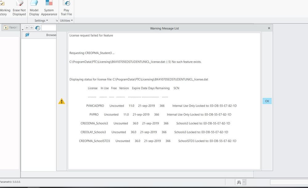

I have installed Creo, and I keep getting license errors.  Attached is a picture of the failure.Capture.JPG

  • go to CREO_LOADPOINT\Parametric\bin directory
  • open parametric.psf file in Notepad
  • replace CREOPMA_Student3 text with CREOPMA_SchoolSTD3
  • save parametric.psf file
  • launch Creo
