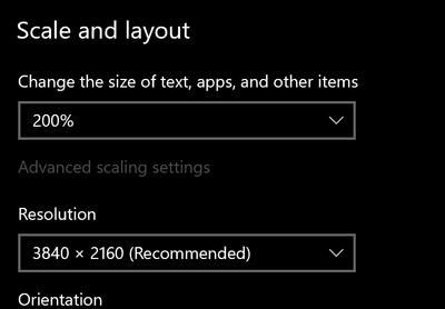

All,
I am running the new HP 15 Zbook with 4K screen and I love how sharp the lines are in Creo View 4.2 especially when viewing a drawing. So much better than the pix-elated words in the notes that you had to pop out to read them better.
This is what I am running.

Yes, these are the exact same Windows DPI settings as the ones I am using, and the sharpness of the image is of course fantastic -- also in Creo.
However, this does not help with the problem initially described -- that the lines (at least in HLR view mode) are microscopically thin. See my screenshot, or try for yourself with HLR view mode on your Zbook.
Apparently, these lines are displayed with a width of exactly one pixel regardless of the screen dpi resolution.
